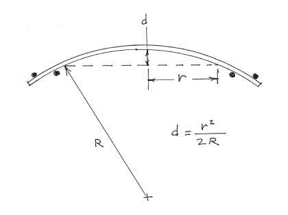

The three-nail setup ( as in Kinkeads's book) doesn't give you a circular arc. The batten has more curvature at the center nail and is locally straight near the end nails.
You can do it exactly with a batten and four nails. Use two closely spaced nails at each end, each pair equally spaced, to curve the batten. Here is a sketch, and the formula to figure how much deflection you need for the radius you want.
The batten will form a perfect circular arc in the center section between the two inside nails.
Phil
